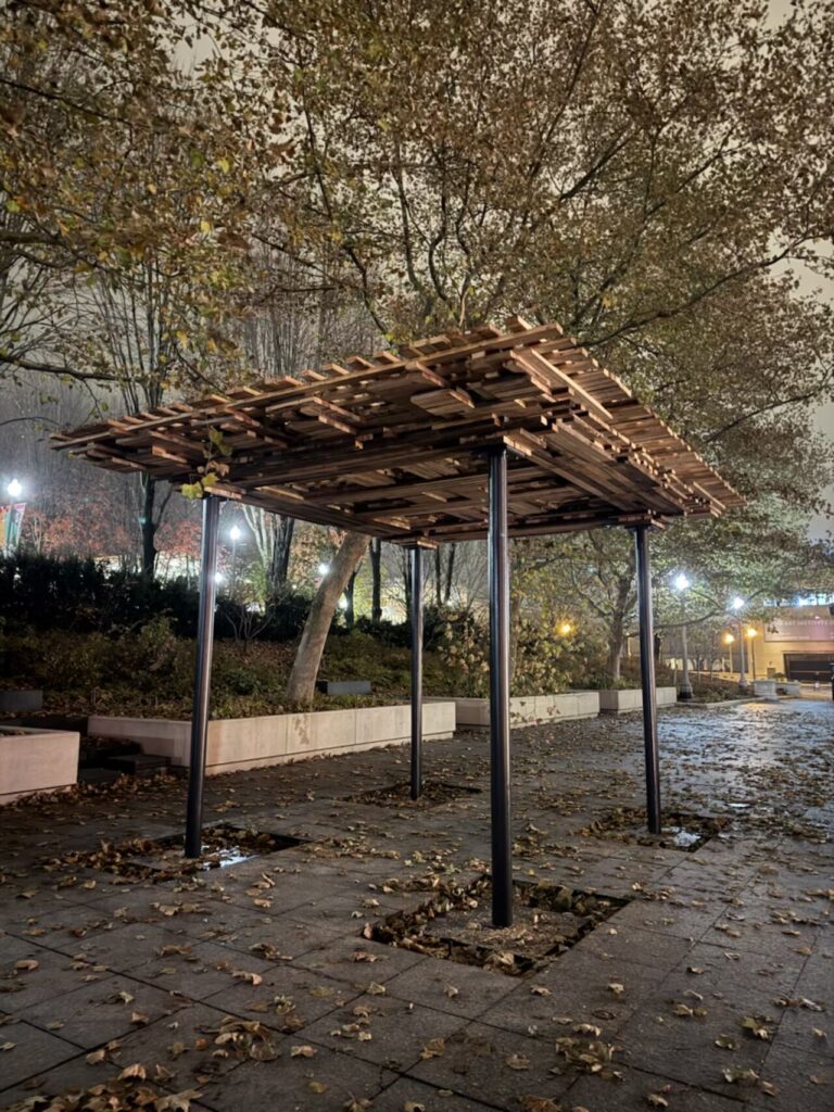

Re-SPLAM installation view. (Photo: Hongxi Yin)

But the benefits, Yin and Henry agreed, are potentially scalable. To create the pavilion, titled “Re-SPLAM (Reclaimed Spatial Laminated Timber),” WashU and SOM forged a series of industry partnerships — with Rebuilding Exchange, Norcon Inc., the Mid-America Carpenters Regional Council and Simpson Strong-Tie, among others. The aim was to demonstrate how material reuse, combined with innovative structural design, can provide an economical, low-carbon alternative to conventional construction.

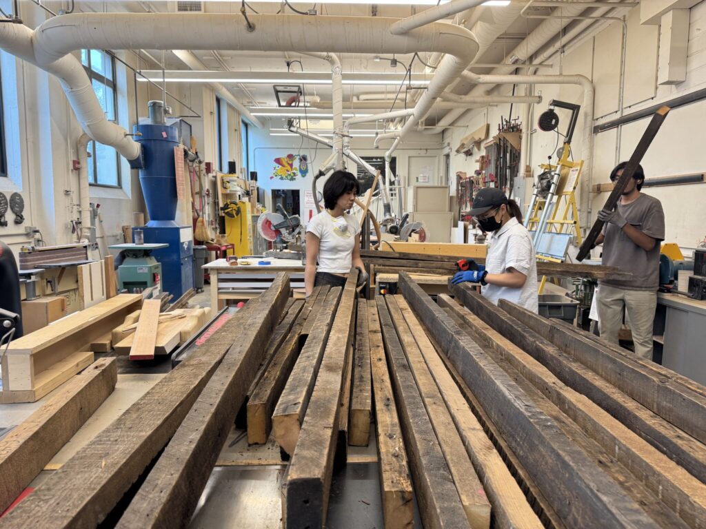

Sam Fox School students Bao Nguyen (left), Xinyu (“Rain”) Zhao and Andres Fernandez-Aguilar sort, scan and catalog reclaimed timber in Givens Hall. (Photo: Hongxi Yin)

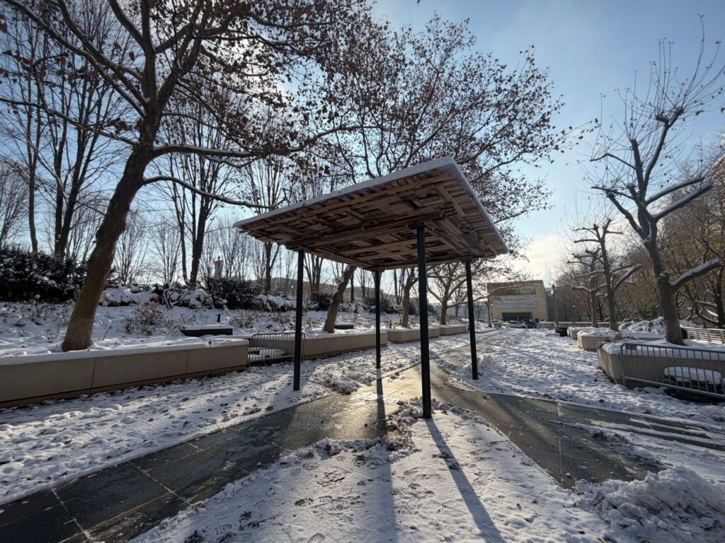

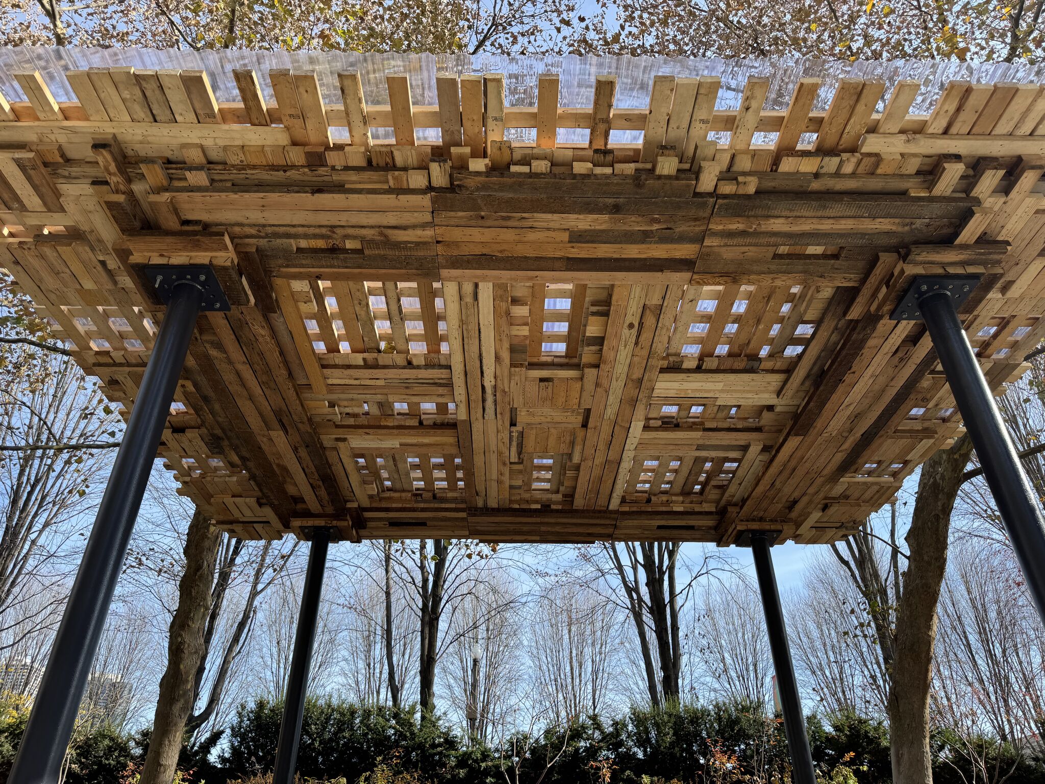

Re-SPLAM, with its canopy of reclaimed two-by-fours, marks a new phase. Over the course of three semesters, Yin and students researched, planned and built a series of scale models. For the final iteration, designed and engineered by SOM, students took the lead on material procurement. Each piece of wood was digitally scanned, catalogued and, through a process of computation design, optimally placed.

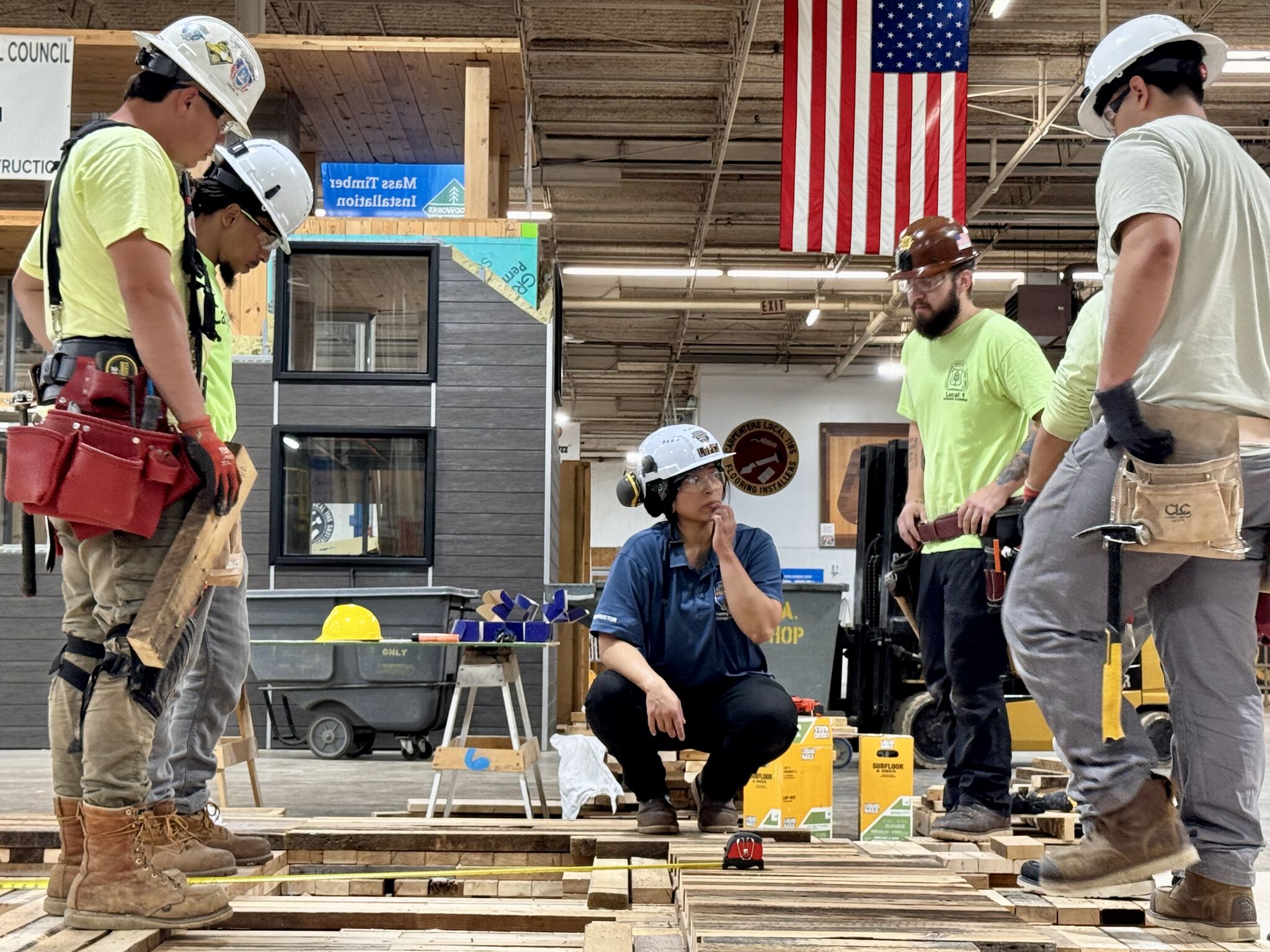

Workers assemble and test Re-SPLAM at the Mid-America Carpenters Regional Council training facility in Chicago. (Photo: Hongxi Yin)
Installed in Millennium Park, Re-SPLAM is almost uncannily strong. In structural simulation testing, it surpassed Chicago snow load requirements, making it a potential alternative to steel or concrete. Further, by actively removing material from the waste stream, and through efficient off-site assembly at a Mid-America Carpenters training center, the pavilion’s construction sequestered more carbon than it released.

ReSPLAM was designed to manage a 2-foot snow load, or 31.3 pounds per square foot — well surpassing the Chicago snow load standard of 25 pounds per square foot. (Photo: Hongxi Yin)
