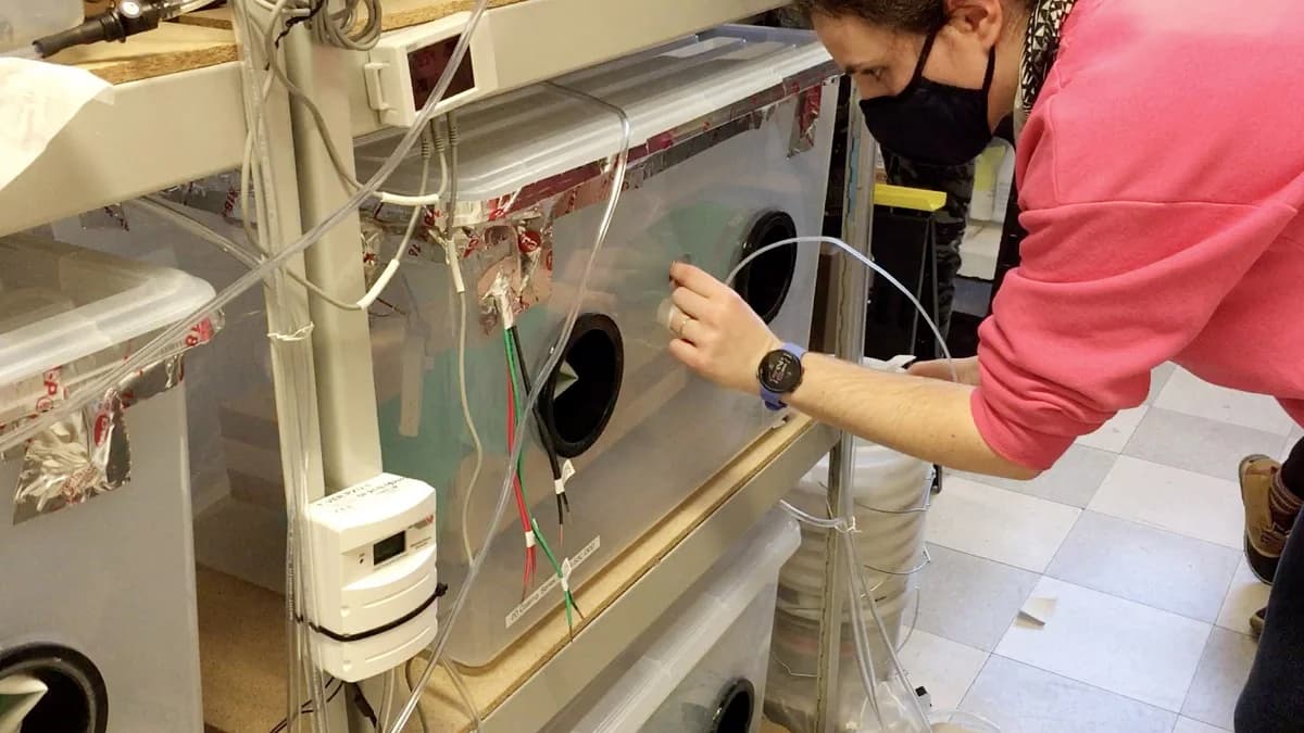

For the experiment, blocks of cross-laminated timber were sealed in disinfected plastic boxes to create a microenvironment with carefully controlled temperature and humidity. To simulate a health care setting, air was filtered and exchanged at rates similar to hospital codes.
The team sprayed the blocks with tap water, inoculated them with a cocktail of microbes commonly found in hospitals, and took samples over a four-month period. An empty plastic box was used as a control.
The researchers compared coated and uncoated wood samples under three types of water spray events: just once, every day for a week and daily over four weeks.
