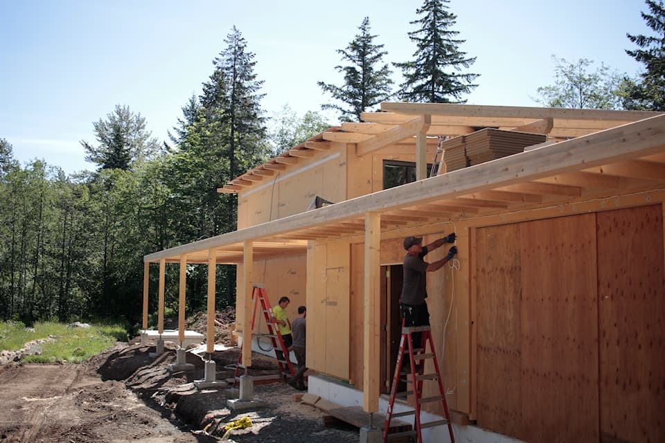

However, the truly remarkable thing is that this isn’t just some modular home that was trucked in and assembled on site. This, according to Grimmer, is the only mass timber passive house on Vancouver Island. Grimmer isn’t new to passive homes. He lives in another elsewhere in the Comox Valley (this house is being built for a family member). Passive home construction essentially creates an impermeable envelope that prevents the transfer of heat from either outside the house in summer or inside the house in winter. That heat trapping makes it very efficient when it comes to heating costs, which has a massive benefit on the environment.
“This is what passive is all about. It doesn’t have to do anything,” Grimmer said, standing at the wall of south-facing triple-pane windows. “It’s just its design keeps it warm or cool, right? It performs just sitting there.”
Passive homes are relatively rare, since they have more strict building standards than conventional homes in North America. There is an international database of passive homes and a certification regime for them. The construction methodology is a lot more popular in Europe than in Canada. In Canada, there are only 109 buildings listed on the database, and there are more than 6,000 in the database. This home will be the third in the Comox Valley, with one of the others owned by Grimmer himself. However, Grimmer believes that this is the first passive home made with mass timber material.
Mass timber is essentially an all-wood construction where multiple smaller pieces of wood are combined into a larger, structural piece. In Gimmer’s project, all of the exterior walls are made from mass timber, which is coated with a thick layer of wood-composite insulation for maximum heat retention. This style of construction is also much more popular in Europe, and has recently gotten the attention of both the provincial and federal governments as a way to shore up Canada’s forestry industry. The province has updated building codes to allow for mass timber buildings up to 18 storeys high.
“Mass timber buildings are made from wood and can store carbon for generations, keeping it out of the atmosphere,” the province’s webpage on its mass timber action plan says. “Mass timber buildings also replace more carbon-intensive materials, such as concrete and steel, and help to reduce construction waste.”
While there are mass timber facilities in Canada and B.C., they are more geared towards institutional and commercial buildings. Grimmer’s mass timber walls were constructed in Europe and shipped over to the site for assembly. The panels have been milled for sockets, and all of the wiring goes through the insulation panels on the outside of the home. There are a few places where the envelope has holes, but those are kept to a minimum. The home is also oriented with a south-facing main wall, with no windows on the opposite side of the building. All airflow is handled by a heat exchanger, and the plumbing is stacked to minimize the number of air ingresses. All of the windows are triple-pane to keep more heat inside.
“Educating the tradespeople is very important because when you need to install something, guys usually get a big auger and put a hole through the wall. You can’t do that here, you’re going to completely defeat the purpose,” he said.
All of this is done to reduce the home’s environmental impact. To meet the standard set out by the Passive House Institute, the building needs to pass certain efficiency tests, including a blower door test to determine how airtight the building is. At the end of the process, you end up with a very green and environmentally friendly home.
